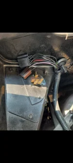

I would say the one that Buick Girl pictured in her post is the one. It is a precursor to the blower module GM used in the 90's and like the one I pictured in post #7. I have replaced the one in my 98 Riviera twice in the 19 years I have owned the car. The very common failure mode is the blower stays on when you shut the engine down. They are expensive parts, 100.00 +.

Now, I dont know for a fact this is going to work, but it works on regals, is the same shape, and I would think the controller in a regal is probably the same as the riviera. The C68 climate option is a rare thing to find in 1980s vehicles, let alone survivors, let alone just how many brand new ones there were. So this appears to be the only reproduction i can find. the module is redesigned so the prongs arent on top of it(water damage and corrosion common)

before replacing it: Do you know your resistor is dead? This is a lot of money for this part, so you would want to be sure. Most resistors when they die will work on full speed but nothing else
