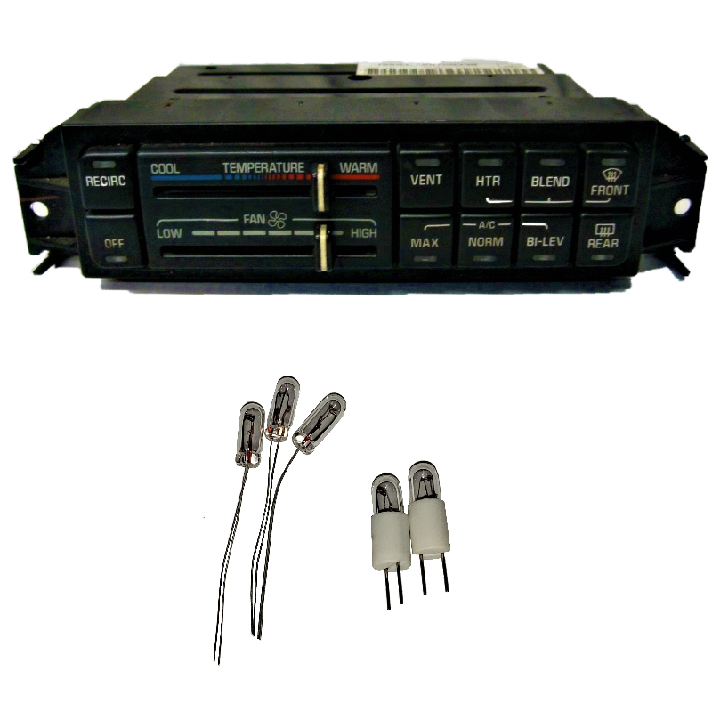

The radio if its not all unlit has small soldered incandescent bulbs. You can send it off to someone to repair, or you can buy them and solder yourself. Its similar to the switches and such which also do this. Its annoying but it can be done by the DIYer with a good technique a solder iron and the bulbs but if not comfortable I would look for a refurbished or to send yours off to soemone for repair.

You may want to consider a GM interface harness and a new radio because of the age your original radio. Seeing how it would require removal for repair it's something to consider look at Sonicelectronix and Crutchfield for options.
Mr O of South Main Auto has some great youtube videos of Lesabres (and many other cars). One linked below is not of the radio bulbs but lights in the hvac controller that shows what the soldering is like. His troubleshooting is amazing. If your are keeping the Buick I really like the idea of new radio with back up camera.
