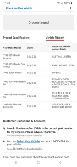

As the title suggests, I need a A/C bracket complete for a 1995 Riviera. I have scoured the internet with no luck. Are there any Buick models with the same setup?
I bought car used and got hosed with NO A/C whatsoever. Most of the other stuff is there though. I need #16 and 17 and 21 would not hurt.ac mount.webp
You need the parts number and then you can check on other models. Here's a source for the numbers.
Put the part number in on GM sites and you should see what years and vehicles share it.

You may want to get this stuff from the junkyard or eBay. There are millions of 3.8 powered cars from that era that likely used the same setup. If you are buying a compressor make sure you get a brand new one. I got one at Napa, I think it was the Napa Temp brand or something, actually made by four seasons. Been working flawlessly for six years.
Thank You, Gentlemen. Thanks to you I have obtained the part I need. These 1995-1999 Rivieras are a pain in the ass to find parts for.
