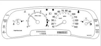

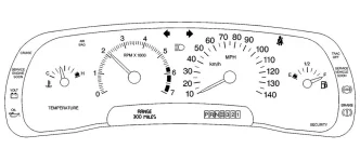

Which of these two clusters is like yours? #1 or #2.
And what is the light telling you to change oil on the cluster?
