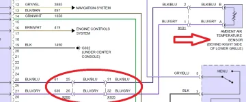

The ambient temperature sensor has nothing to do with your HVAC. The only use of this sensor is to determine whether or not to turn on rear defog. ( Steering wheel and heated seats if so optioned and selected in menu ) when you remote start your vehicle. Engine has it's own intake air sensor. On Trax forum some people have found the connector's pins behind the left kick panel would corroded from salt soaking the carpets and leeching to the wires. They spray cleaned this connector and plugged and unplugged several times to clean the contacts. Added dielectric grease and this seem to clear this problem. The 2 wires from the sensor come directly to this connector before continuing to the instrument panel or human interface if you have Navigation. It's not a difficult job just a hard place to access especially at my age.
