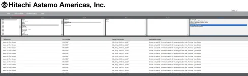

Recieved this code with an intermittant CHECK ENGINE light. Apparently, the cure is to replace the Mass Air Flow sensor. I have seen in other places on this forum that the recommended replacement is a MAF0005 from Hitachi. Rock Auto lists a Hitachi MAF0047. Do I get the 0005 or the 0047?
Thanks to all!
2002, Base Model.
Thanks.
