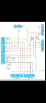

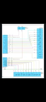

Alright I've been trying to do this for a few months apologies again I rebought new buttons since last ones burnt out I have the wiring diagram for the whole shabang I've been trying to get the lights to turn on outside the vehicle and get the modules to work off my fully charged battery I cannot get the memory seat wiring to work nor the button for the driver or the passenger side to work I've been trying to turn the heater and cooled settings but i haven't been able to figure out the pos and negative wires and I'm in a rut because once it works outside the car figuring the rest out will be easy here's the wiring diagrams for the seats any insight will help I'm struggling 😭 1000003084.webp1000003085.webp1000003081.webp
