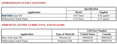

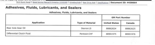

I recently bought a used TourX and I have a lot of questions )) . I want to change all the fluids in the AWD system. But there is very little information about the points for the all-wheel drive service. I found information on only two points: rear gear (recommended Rear Axle Gear Oil Dexron LS and front gear (recommended Differential Clutch Fluid Pentosin CHF ).
Please tell me how many 4WD service locations are there really?
I don't believe the Clutch Fluid really gets changed. It's a hydraulic fluid and a bleed procedure from what I understand.
The two AWD service locations that people service are the transfer case (located up by the Engine) and the rear differential. Both are very easy to service with normal drain and fill plugs. I highly recommend getting the factory fluids as it's a gray area as to what exactly the fluid requirements are.
Transfer case uses the ACDelco 19351882 (AKA unicorn tears) that's about 80-100 dollars for a quart. Only one bottle is needed.
Rear differential uses the Dexron LS that's about 15-20 dollars on Amazon. Only one bottle is needed here too.
Thanks a lot! Now everything is clearer to me.
I have only one question left. What is this Pentosin CHF 88901975 liquid for, which is mentioned in the manual 🙂)

The Pentosin is the clutch fluid.
