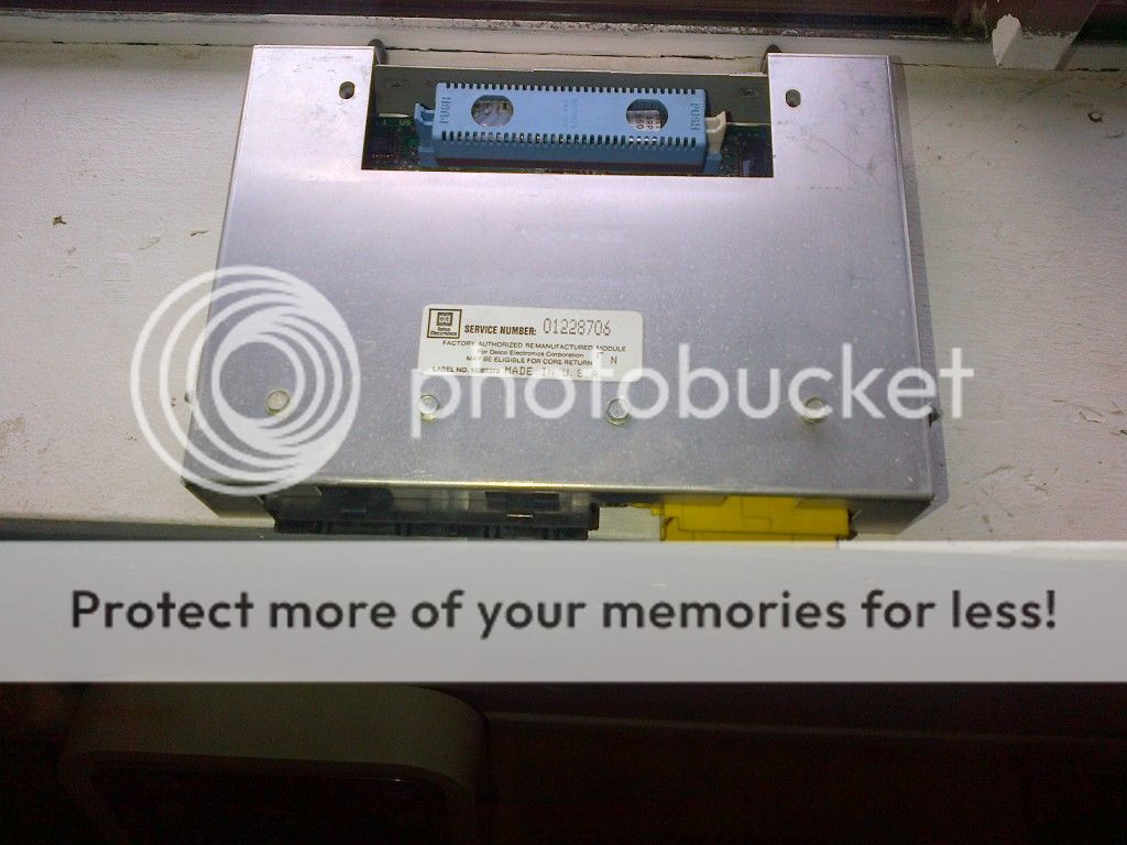

Now I'm really lost! Well the ECM came in yesterday and they didnt call me so I picked it up today. I checked the fuses with a DMM, all passed. The ground pin on the data link was at 3.6 ohms, the canister purge solenoid seemed a little high at 25 ohms(I say this because the ECM that was in the car was a reman already, a sticker on it says to "test circuits with ohm meter, should not exceed 20ohms or warranty void"). Both the high and low cooling fan relays clicked away when voltage was applied, not the ideal test but they functioned. Relays were all at 75 ohms, pin 85 to 87(can't remember which pins for sure, the ones that give you a resistance value haha). It should be mentioned the old ECM was not properly fastened in and loose when I removed it. Vibration issue? Either way I went ahead with putting in the new computer.
I disconnected the battery before I started pulling the ECM out of course, was a fairly easy job albeit on my back on the floor of the car(don't lay on the trim screws after you take them out, they hurt a little stuck in your back). I swapped the PROM and cover over to the "new reman" unit, made sure it was clipped in all the way and secure by the tabs on the end of it. Had them next to each other oriented the same way to make sure I didn't do a 180 with the PROM chip. Only snag really was catching a tan or possibly tan w/white stripe wire on a fuse box down there on install, I stressed it a little but didn't try cramming the ECM in there so I think it's okay. Didn't seem loose when it was plugged in so I didn't pull the connector back out and check the end. The schematics I have say it goes to the MAT sensor, but then again they are from Autozone and they couldn't find me axle seals for a 93 Taurus. The eye candy they hired a few months back told me to try the dealership, for a regular stock item I know they have probably a half dozen of. I'm off topic, sorry it's been a bad day.
I did a DLC jump test as per the reman ECM instructions provided with the unit before attempting to start it. It gave me the start/end code (12), seemed to hiccup or stutter, and then gave me the code 12 again. I thought okay, a little weird but lets see. It really seems like the high speed fan circuit is now running with the DLC test where it was the low speed fan running with the old ECM. I'm about 98% sure it's running full speed now. There was some clicking from under the hood the first time I ran the test, seemed normal enough. After that test the alternator was humming/buzzing while the key was in the on position, I know it didn't do that before for sure. I never tried to start the car because I decided to run the check engine light again at this point. The light was staying on with the key turned to run so I figured what the hell, "scan" it again. This time it was like a meltdown! Started off normally with the start code 3 times, then gave me a code 41(3x) followed by a code 42(3x). After it finished the code 42 the light(it looked like it was shorting out, had a diminishing flicker so to speak) and a bunch of stuff under the hood went nuts(very rapid erratic clicking from several locations), couldn't pin point it as I turned the key off and pulled the paper clip from the data link. I was trying to keep damage to a minimum if possible because it was pretty obvious something wasn't right. There was a lot of sounds goin on but I swear I heard a sizzle type sound and got concerned. The car still hasn't been started at this point.

So at this point you have not tried to start the car? Did you pull the battery cables off the battery while installing the ECU to both protect it and to clean everything? Try pulling them again just in case the computer got a bit wonky initially. The PROM chip only can fit one way into the computer so there is no worry about how to install it. The correct way will cause the tabs that hold the prom to latch to the PROM. There is only one way to program the OBDI computer and that is to replace the PROM, so you are correct the stealership was feeding you a bunch of bull.
I wonder if the computer was wrong for that model? (they all look the same)
This is mine from my 1989 Century(with the PROM cover off it)
It looks the same as yours, Verify that they sent you the right ECU.
I am wondering if it is the PROM that is the problem?

The latest revision of the PCM for an '89 LeSabre VIN-C should be ACDELCO Part # 88999198 {#1228253} and replaces the earlier version, which was #16198264. The original should be labeled with #1228253
Where to begin, the axle seals in the taurus would've been fine but I have the transmission out and sitting on a table waiting for the shift kit before it goes back in so figure'd the time was right. Funny you mentioned the front pump seal which is actually leaking, Ford dealerships are currently holding all of the seals with the part number I need for a recall lol! I can try giving them my vin and roll the dice. Parts guy there is just amazing though, know's his stuff and willing to go above and beyond everytime.
It would have been REALLY nice if the previous mechanic wrote down the numbers off the OEM ECM, all the spaces for information were blank on the used reman unit. I can only speculate what the original ECM part number was unfortunately. The BWD "new" reman carries the 8253 part of the Delco part #, as does the reman unit which was in there before. My ECM does look like the one you posted a picture of Journeyforce, the harness plug on the right side is orange on mine but otherwise the same.
