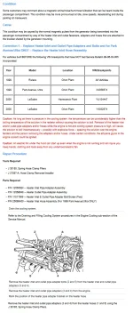

I bought that gates kit...im watching a video on replacing the thing...it talks about replacing the heater hose fitting orings...did you do that?
Depending on age and condition the inlets and especially the O-rings should be replaced.
When I received the fittings they had new "O" rings already installed, just put a little silicone lube on and put them together.
