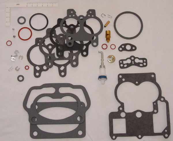

Have you considered a rebuild ?

If you buy from a known carburetor service I would not worry about the quality of the parts in the kit
There is absolutely no reason to go to a Holley, and you don't need an electric pump, the mechanical pump is all you need. You are literally asking for trouble by going electric. All you are doing is adding more failure points. Any carburetor re builder can make your carburetor like new. Make sure they use ethanol resistant parts, and check the throttle shaft for worn bores, it can be bushed. I recommend Everyday Performance. He rebuilds Quadrajets, but I bet he can service your 2bbl. Contact him and ask. Ken does great work.
