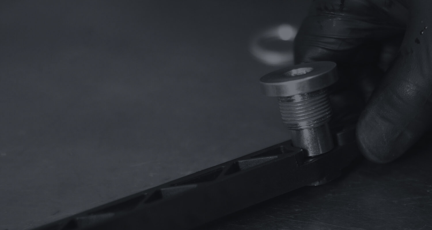

Oh- I would like to add that there is an upper bolt that is especially prone to wear. That bolt is hidden behind an aluminum plate and holds one of the plastic guides.
Dorman has a fix for that bolt with a nice case study. I'm not 100% clear if this can be done on the car with the timing belt tensioned.
I guess this guide/bolt and the top tensioner are the high wear parts. Maybe a streched chain is a driver. Or maybe driving with low oil is a driver.
