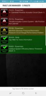

Edit>>tonight it also threw p0010 cam position actuator, p0106 manifold absolute pressure, and b2aaa which is a bogus/ghost body code.

After this onslaught of codes it's not running right even after clearing them and cycling the ignition until it did not go into reduced power mode. So I could go over 40mph, but....i went to get on it after I picked up my son merging on the highway and it's like I was pulling a trailer. I pulled out the torque app and it showed at most 42% throttle with my foot to the floor.

Ignore the p0420 I was catless a hell of a long time before this shit started.
Cam actuators will cause car to lose all power....so replace. You have them, so no reason to wait. Did the work and hardest part is electrical connector setup. There is a removable bracket on top that needs to go first.

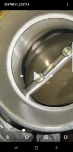

Got the solenoids changed, evap, and throttle body connecter loose albeit one tiny portion of the twist lock tab snapped off. I think it'll hold back together fine...but the part that broke dropped down into the pipe. It's dark now. Tomorrow I'll jack it up and try and pop the fang out of the bumper to disconnect from the intercooler and get it out. Put the new tb on and go from there. Tb is dirty. But I guess I would expect more for it to be the culprit.Screenshot_20170811-204242.webp

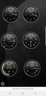

I noticed the ambient temp missing from my display when I started it back up (unhooked battery)...in browsing through the pids in torque I saw my oil psi was constant and low. I know when I had my powerstroke the preloaded pids weren't enough and you had to manually add/delete some. Is this preloaded torque pid just looking at the wring thing? I would think oil pressure that low would throw a cel. Screenshot_20170812-163744.webp

I noticed the ambient temp missing from my display when I started it back up (unhooked battery)...in browsing through the pids in torque I saw my oil psi was constant and low. I know when I had my powerstroke the preloaded pids weren't enough and you had to manually add/delete some. Is this preloaded torque pid just looking at the wring thing? I would think oil pressure that low would throw a cel. View attachment 10952

Got the solenoids changed, evap, and throttle body connecter loose albeit one tiny portion of the twist lock tab snapped off. I think it'll hold back together fine...but the part that broke dropped down into the pipe. It's dark now. Tomorrow I'll jack it up and try and pop the fang out of the bumper to disconnect from the intercooler and get it out. Put the new tb on and go from there. Tb is dirty. But I guess I would expect more for it to be the culprit.View attachment 10945
