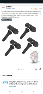

Lucerne
2010 Lucerne CXL.
What is a good replacement for the TPMS sensor ?
Brand and model number would help.
Thank you.
