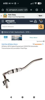

I did pretty much what everyone has mentioned (TransGo 1-2 & 2-3 accumulator springs & spacers, the 2 TSB magnets, & Sonnax Lube Tube retainer). I did however, also replace the piston seals (O Rings) and the accumulator cover gasket. We'll see how this plays with the occasional P1811 I've been getting when the trans is very hot.
