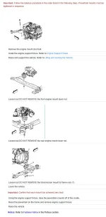

There is a TSB for your car that involves using shims on the engine/trans mounts to eliminate vibrations, and doing what i suggested above will help determine if that is the fix.
Tighten
Tighten the bolt and nut to 70 N·m (52 lb ft).
This is for a 3.8. if you have a 4.6 i can get the procedure specific to that one. this specific procedure is about removing preload on the engine mounts which could contribute

If the vibration remains, then I think that rules out the transmission and mounts. But thanks for the info about the shims for the mounts. 1st I've heard of that TSB.
View attachment 48734View attachment 48735
Tighten
