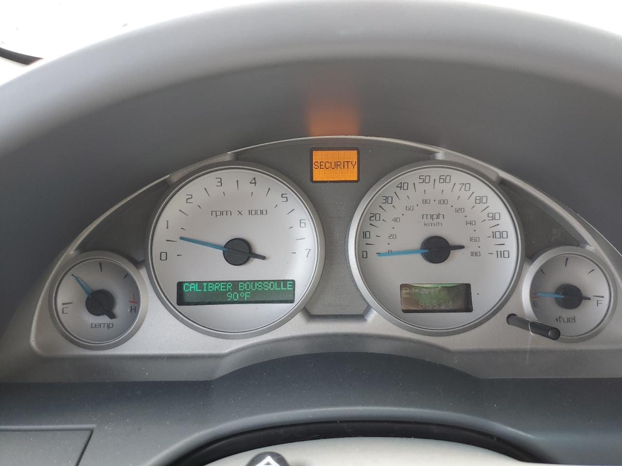

The pump gets power when I jump the relay. It should pump. When I remove the relay jumper there is no longer power, I checked. There are only four wires. A big gray and a big black. These are pump power and pump ground. And then there are a little black/white and purple. The purple and black/white wire is the resistance and ground wire for the gauge.Thats why I said this....
So your headed in the right direction. Unfortunately, I cant help much further than this. It could be a relay, PCM, BCM, or??
Electrical is not my fortay.
No. As I said, the relay is working properly. I have power at the fuel pump. The fuel pump is not running when it has power. The fuel pump is bad.In my humble opinion... The problem has not been found. I think doing all/any that is overboard.
Need to definitively find the problem at hand, and then find the course of action.
What you do know is that power is getting to the relay, but the command to switch the relay is not happening?
If you bypass the relay, the system pressurizes, and the car starts?
So the command to the relay is where the focus needs to be.
What conditions have to be met for this to occur, I dont know.
