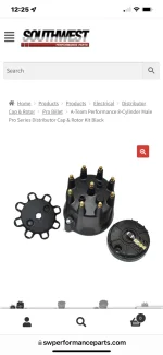

Sorry I have not been back for an update. So I was able to track down the Distributor Cap and Rotor set from Southwest and once the parts arrived I changed them out. I noticed the older cap had the missing center button/ball so I decided to get these installed first. Once that was done and I still got not spark, I suspected the Ignition pickup coil went out. I jiggled the wires and no luck. Now I need to order a new pickup coil or just replace the whole distributor and start over, which is where I am leaning.
