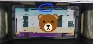

Yes, you have to run a video/power cable from the back of the radio to the back of the license plate area. I just ran it in wire loom underneath the carpet, through the back seat, into the trunk area, using the factory wire loom to hide the wire.
https://www.amazon.com/dp/B072PSDPDZ?psc=1&ref=ppx_yo2_dt_b_product_details
The camera I got is part of the license plate frame bracket and uses security screws to protect from theft.
https://www.amazon.com/dp/B07CRMSTLC?psc=1&ref=ppx_yo2_dt_b_product_details
