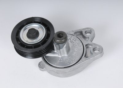

Does Item #8 tensioner/pulley below look like what you are looking for? The pulley alone looks exactly like the pulley used for an idler pulley for the PAU supercharger belt drive. Here is a pic and the dimensions on that particular pulley:
Number of Grooves 6
Material Thermoplastic or metal
Contact Surface V-Ribbed Grooved
Pulley 1 Flanged Yes
Outside Diameter (mm) 76
Bearing Bore Inside Diameter 1 (mm) 17
Width (mm) 25
Contents Pulley
Number of Pulleys 1
http://www.amazon.com/ACDelco-10186...automotive&vehicleId=2&vehicleType=automotive
http://parts.nalleygmc.com/showAsse...1996&ukey_category=19395&ukey_trimLevel=14752
Well, it looks a lot like it but how can I be sure without taking the old one off?....Any thoughts on the electric fan conversion?...With the fan and pulleys removed it would leave plenty of room in there for the electric fan but I wonder if the electric fan moves enough air to keep it cool?...
