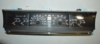

I'm having issues with the instrument cluster and I was wondering if anyone had any experience with these. Essentially, the speedometer works, temp gauge works, gas gauge works, and all the lights work. However, the tachometer and oil pressure gauge don't work. When I bought the car, the oil pressure gauge worked, and now it instantly pegs out to the max when the ignition is switched on without the engine running. The tach never worked, it rests on the redline peg and doesn't move. When the car is revved near redline it moves backwards slightly but that's it. I have already pulled the cluster once and didn't see anything obvious when it was out.

so its pegged when off? It may be physically in the wrong position inside if its doing that all the time

When the ignition is off, the gauge moves back to 0. I tried unplugging the sensor and it does the same thing. I'm guessing it's something to do with the actual dash, but I'm not sure.
the tachometer is moved by the Ignition Module under your coil (single piece of plastic with all 6 plug wires on it) If you are talking about the tach. I dont know what your reply is to because you didnt reply to both of the things I said.
do you have a t type cluster or a normal one
it would be nice to see it
Sorry, I misunderstood what you said. Yes, the tach is always pegged at max, even when it's off. I'll attach a photo when I can, my dash looks just like the one you attached. If there's corrosion under the ignition module, could that cause an erratic tach? It looks pretty rough under there. Thanks!

Do you have an T type?no the corrosion isn’t likely to be the cause if your tach is maxed when off. But it is still helpful to pull it off and clean the module to the engine bracket. Then use thermal paste to increase the heat transfer and prevent corrosion. If you have a single coil with 6 posts, if it ever goes bad I recommend upgrading to the 3 coil style which requires a bit of eBay hunting for a bracket from early series 1 engine to do so

It's not a T-type, it's a Limited Sedan. I'll clean up the corrosion and see if that helps. Yesterday the harmonic balancer split in half while I was driving, so the instrument cluster is going to have to wait for a bit! Do these dashes have stepper motors? I wonder if it experienced an internal failure, or maybe a chafed wire.
No, not stepper motor, its going to be coil-type tachometer, so no sweeping when key on. Your needle could just easily be stuck or there is a bad component, it should be easily fixed by sending off if its failed

Great, thank you. Who does repairs for these dashboards? I ordered the parts to fix the balancer.

I have attached pictures of my dash, one pic with ignition off, one with ignition on: (Sometimes the oil sensor sits at 0 when off, sometimes it sits at 40. Not sure why)
