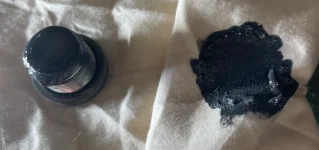

Update to my DIY above. I would not recommend using anything other than the ACDelco Dexron LS gear oil.
From the repair data: "Installation of the incorrect type gear oil may create a "moan" type noise within 7 770–25 900 km (3–10,000 miles). Fluid that is "black" in color is to be considered normal and is darkened by the carbon material in the clutch plates."

So.....I just wrote a ticket on my car (2018 GS 17000 miles) last week and had our techs check it for this EXACT concern. Ultimately, the rear diff fluid was just changed out. However, my tech came to my desk and told me to come take a look at something when he drained the fluid. In all the years I have been writing service, I have always known Diff fluid to be clear or brown, depending how dirty the fluid is. What I saw come out of my rear diff was JET BLACK. Neither my tech or myself had ever seen this before. He said GM was telling him to just change the fluid. He told me if the sound came back, we would just replace the rear diff. Here is a screen shot of my complaint and his diagnosis. As black as the fluid was, im expecting we will be replacing the rear diff down the road
