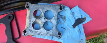

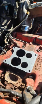

Forgot I took these pics when replacing the intake gasket. There is some sort of adapter plate before the carb. Other than the lean backfire (which only started yesterday) it has run perfectly fine for the longest time. Just had a bit of trouble understanding timing over the past few months that had it running a bit screwy, but that may have also been a combo with the distributor.
The adapters are horrible. They totally ruin air/fuel distribution. Either you need a Quadrajet or a spreadbore Holley carburetor or a square bore intake.
