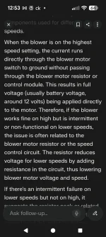

Hey I really appreciate the help from you and everyone else! An I have had it on high/med/low it doesn’t seem to matter, it will go out and sometimes if lucky it will come right back on, but that’s not happening anymore! But yesterday it was a little bit warmer, I was driving an it came on but as soon as I turned it off., I waited bout 30 minutes and nothing… Again I sure do appreciate you!Did you say whether it works with fan all the way on high? It makes a difference. Read the below photo content.
Sorry I didn’t see this till just now, it will be on High and go out! I really appreciate your help!.... exactly my point
Same thing happened to mine. It was this: More Information for UAC SW11299CHey I really appreciate the help from you and everyone else! An I have had it on high/med/low it doesn’t seem to matter, it will go out and sometimes if lucky it will come right back on, but that’s not happening anymore! But yesterday it was a little bit warmer, I was driving an it came on but as soon as I turned it off., I waited bout 30 minutes and nothing… Again I sure do appreciate you!
