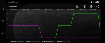

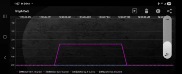

I finally checked it with Torque Pro today, and had it scan for misfires while I drove it through several moderate pulls from a dead stop. Some pulls felt perfect, other pulls I noticed the hesitation. I found misfires on all four cylinders, but mostly concentrated around cylinders #2 and #4. Attaching the screenshots from Torque taken during the shudder window. Taking it to local H&H Automotive next week ... is it carbon deposits, or a failing High Pressure Fuel Pump (HPFP), or ¯\_(ツ)_/¯
