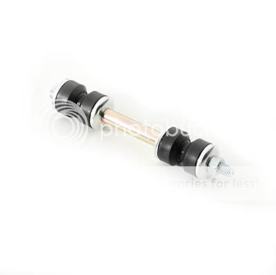

pictures would also be really helpful. please and thank you.

Yea, if you tighten to 113 ft. lbs. the bolt would break! 17 Nm is more realistic, which would be 12.54 ft. lbs. I would recommend replacing all the parts of the assembly since bushings get hard & wear out. In addition, two pack assemblies with polyurethane bushings can be purchased at any parts store for less than 20-bucks (including TAX) 😉The torque spec above is NOT correct. Do not torque to 113 Foot Pounds. It should be around 20 to 40. I don't have a book handy to look it up but look it up and torque it. You can just crank it down but the right torque spec also sets the link at the correct length or close to it. If you just crank it down as far as it goes you might get away with it but it will preload the bar more than it's supposed to be.
