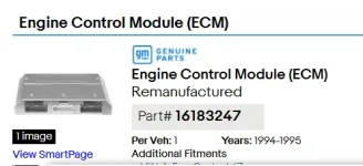

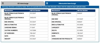

here is a list of part numbers for your PCM
