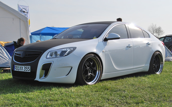

oh, but here is a pic to wet your appetite from one of the international forums I am on:
Lowered with wheel spacers to get the "flush" look. It also has staggered wheels, not sure if I am a fan of that on a non-RWD car.
I like the stance on that car. I'm iffy on the paint job. Looking forward to your results and hope to add lowering springs to my own car in the future.
I love that stance!!! Not crazy about wheel spacers, I'd go for another set of wheels and tinker with offsets to push the wheels out. Not the exact same result as spacers but it can improve the stance significantly.
I'd stagger it depending on the car, I can understand why people do it on a FWD car, it does look good personally...I wouldn't though. Although you'd have to be a little more careful when deciding to take a corner hard as it can induce more understeer, given more grip in the rear. As long as one realizes, it's pretty much cosmetic and nothing more.
