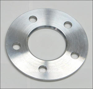

not only do thousands of people install them but millions of people buy aftermarket wheels where the offset isnt always OEM. the spacer doesnt have to be welded or apart of the wheel to get the same affect in my eyes. my last cars OEM offset was 55+ with a 7.5" width. my racing wheels were 44+ and a 8.5" width and i never had a problem nor did guys running as low as 35+ offset.
only issue i have is if you use the ones where its just a spacer and the lug nuts lose threads. thats a little scary.
Adding offset with different wheels seems safer than slipping on spacers. Maybe it's just me but I find it scary to have a piece of metal "float" in between the hubs and wheels. 😱
I understand that. But then you remember it's not floating since the holes are cut to the size of the studs and you have 5 large lug nuts holding everything down with a torque spec of at least 85lb each. If they don't loosen after a few miles they never will.
PS wasnt sure if you meant floating like I use the term. On a race bike our rotors actually float around the hub ring. I mean you can grab it and shake it a few mm. That's something that really floats.
@ synolimit - "Float" is just a loose term I used. As I indicated earlier, I'm not an engineer so I am not debating whether to use or not to use.
Personally I would not want to lose 3 or 4 lug nut turns.
I gotcha, was just checking. And yeah the thread lose was my consern too. However some guys buy APR longer studs. PITA to replace but covers your butt and they're WAY stronger as a lot of people don't know torque specs and just use the German saying "Goodintight".
