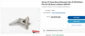

The passenger side motor mount(Torque Axis Mount) is sold new and I have replaced mine, its a bit of a process but its doable. if you dont notice excessive vibration while accelerating you can put it off.
Bracket #10 and Mount #8 and the hardware sold that attach it should all that is needed. A junkyard 1999+ should have those parts if you want to get them off a car, but the bolts are still sold new and the bracket is found easily on ebay.
25740664
note that any 1999-2005 Buick Park Avenue, 2000-2005 Buick Lesabre, 2000-2005 Pontiac Bonneville(with a V6), 2001-2003 Oldsmobile Aurora(With a V6) should be found with this bracket on the transmission. its a bitch to get out on car because of the clearance for the large bolts. I had to use a ratcheting 18mm wrench(I believe) to get them mostly in and out
#7 on the new updated parts diagram and the #10 on the one matching your car are the same bolt 25643132, this is the one with the hook that locks in on the part (mine rounded replacing it so I had to pound a 14mm socket onto it, originally was 15mm I believe) #34 and #6 are the same part number, 25643131, this is the bolt that holds the mount in the wheel well down onto the cars unibody frame rail from by the EBCM (Abs module) hidden behind connectors and wiring for the wheel speed sensors and ABS module. The bolt is "Staked" to the body by another bolt as to prevent it from turning so you can remove the nut without having to have someone hold it from the other side for you.
#9 is the same as #12 threads and use wise but the coating is different , apparently it was galvanized in 1997 but no longer was. Thats the nut for the bolt described above. 1151607811509699 is the bolt mentioned above that stakes the other bolt to the frame rail. #33 and #36 on the diagrams
#11 and #9 of the diagrams describe 25816658 as the bolts that connect the bracket to the trans cover, so they are the same. Lastly, my diagrams actually fail to show a nut for the new mount on the driver side wheel well in the visual and listed format... so if you get the new mount you should check your fasteners from your old mount, one of them would only be needed. The nut should be flanged and should be 9.8, 10.9, 12.9 if you have to go to a hardware store. Mine were from a hardware store because I ended up cutting the shaft of the mount because the nut was so seized to it and the mount was shot anyway so it just spun in place. If your bolts on your 1997 are flanged and have the same threads, they will most definitely work. keep the spare if you ever need it again.
25740664
