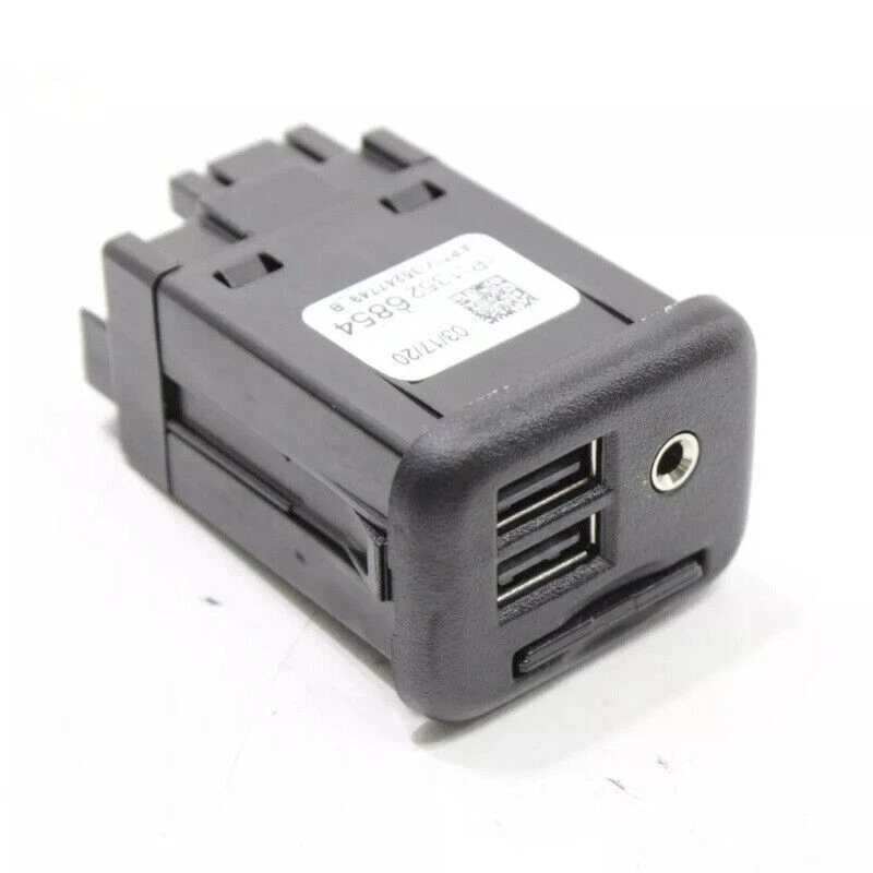

Console USB ports are used by may GM vehicles, so they are relatively cheap and easy to obtain.
I did a whole write up around here somewhere. I wanted to upgrade the OEM single USB module to a module with dual USB and a 3.5mm analog audio port. I figured you could just change out the module, but it wasn’t quite that easy.
I ended up testing 3 or 4 different modules and documented what worked and what didn’t. That reminds me, I need to post them for sale on eBay.
My quest to upgrade the factory USB module in the center console is finally complete. I have replaced the factory-installed module, part #13596807, with part #13519224 and it works flawlessly.
I now have two power/data USB ports and a 3.5mm analog audio jack instead of just a single power/data USB port.
So, just to clarify the part numbers I tried, their port setup, and whether or not they worked, here’s a list:
Part #​
Description​
Compatibility​
13596807(1) USB PortFactory Installed Module Full Compatibility
22990883(2) USB Ports
(1) 3.5mm Audio Jack
(1) SD Card Slot
USB Ports - Power Only
Audio Jack - No Signal
SD Card - No Signal
13536589(1) USB PortFull Compatibility
13519224(2) USB Ports
Full Compatibility
I‘m still hoping to find a compatible module with the SD Card slot, but I can work with what I have.

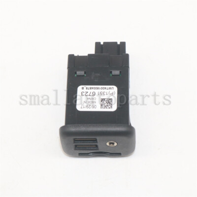

Sorry to necro this post, but it seems like the issue I'm trying to resolve was referenced here.
The usb ports in my 2018 Regal Sportback stopped working a long time ago(tested with both Android Auto/usb drives). They still provide power, but AA won't start, and a thumb drive I used in the past stopped working.
I'd like to switch to a wireless adapter, but I would need to either replace the receptacle/cable or both. I'm thinking about just putting a new cable and stashing it and only connecting wirelessly, but can't find info on which port is used(I have used an adapter for audio). It seems like I'd need access to the bottom side of the receptacle to release the clips, which is something I don't want to do(removing center console).
Has anyone seen diagrams for the usb port on the head unit connectors? It looks like some models could use a standard usb cable?(image attached does not fit my car)
Also having the same issue recently. USB ports are no longer charging my phone or starting android auto (wireless charger doesn't charge my phone since its an older standard). This happened after the SD card error while using the navigation. Removing and reinserting the card doesn't work, the car has to be turned off and restarted. If the usb ports don't work, obviously a wireless android auto adaptor that needs a USB for power isn't going to work.
Saw a reply to this, forgot to come back with an update.
I was able to bypass the cable with a USB mini OTG cable plugged directly into the head unit. This is located near the passenger 'kick panel'. The plug GM uses for the stock cable is proprietary(as I had linked earlier), but it's just a mini usb housed in a custom plug. I hooked up a wireless dongle, and I'm now able to use AA.
@Undercover87T - I'm not sure if this would also work for you, I always had power to the ports(no data though).
