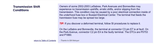

I've got an 05 LeSabre that was doing things VERY similar to what you described and it had absolutely nothing to do with the mounts. Mine was the transmission shift solenoids. After replacing them I've had no troubles. Good luck!
This car previously had the issue with max adapt and the car would shift hard in all gears after being warm. It also has the transgo shift kit which eliminated that particular problem.
The next step was to change the solenoids but from my understanding, it requires the side case of the trans to be removed. Was it hard to remove the side at home or in the driveway? Or did you have a shop perform the work?
