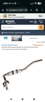

Hi, I bought this part 24243134 to replace on recommendation since I'm doing a shift kit and magnet with a filter. Could you explain where it goes and how to install it or a link to a video or step by step guide on a website please? I don't want to screw it up🙂
I found this in a thread thats older that we have as a community collaborated on, here is the installed pipe.
