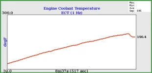

The check engine light has been intermittent and it's a cooler and cold weather event. In warmer weather, it never comes on. And, sometimes, even when it's cold, it might randomly go away. This is on a first-gen LaCrosse with a 3800 Series III V6.
I have an OBD-2 reader. It's code P0128. A state emission check board published it's one of the more common failure codes on many cars ... toward the bottom of their top 10 list.
I talked to a mechanic last summer while he was doing something else for the car. He mentioned that, most of the time, the thermostat has become just a little off and the computer is so sensitive that it picks up on it. He also asked me if my temperature gauge was reading a hair lower than normal. It always does when the check engine light goes on for this code. My temp gauge is normally at 3/8 of the way up from C to H. With this situation, it's a little less than that.
The internet articles I've read say it's either the thermostat or the sensor almost all the time. It could be some grounding or something else. It was interesting that this mechanic who owns a GM car and does a lot of work on GM immediately thought this is what it could be.
Have you had this code or do you know about it? Did you change your thermostat? (In almost 12 years, mine has never been changed.) Or did you change the engine coolant temperature sensor? Or both? Was the engine temperature gauge reading a little lower than usual? No change in driving quality or fuel economy when this light is on.
