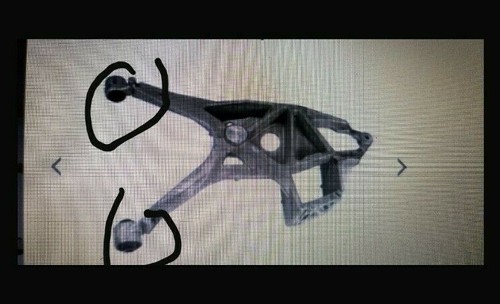

thanks for reply, I found these but the center piece which the bolt goes through not to pure looking due to the point made where the ends come together,
GM does not make these bushings anymore and GM discontinued making the rear lower control arm and no aftermarket exists for it. So in other words, there are no options but these bushings. If these don't work, then we are SCREWED as nobody makes a bushing for it.
Per MevoTech it shows: 2000-2002 Buick LeSabre - Rear Lower
Unless 2003 -2005 had different rear LCA bushings from the 2000 - 2002, these should work. If they don't, 2003-2005 owners are screwed.
The bushing is interchangeable, and the same control arm was used on all the cars, the buick lucerne uses them even.
Yep, those are the MevoTech bushings. Only manufacturer I could find that makes the rear LCA bushing for the LeSabre. So the only choice is that one. Beggers can't be choosers 😉

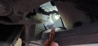

The reason I brought up the lucerne is here is a 2006 I think lucerne and then a 2000 or 2001 park avenue (top v bottom) in that order
also what im saying, is that they truly dont wear all that much compared to the front, hence why i think diagnosis of the problem is likely more going to be the subframe back there, or some other component.
The definitely don't wear like the fronts but they dry rot over time due to age.
I saw a service online that claimed to rebuild the mounts. I bet you its a really dense piece of rubber thats rolled inside and since the rear has a small amount of pivoting it has to do, the wearing out yhou see happens. is it loose side-to-side? If it isnt, id spray some rejuvinating stuff on it just to cut down on the dry rot part a tiny bit, maybe squeak if that happens. other than that, not much you can do then lol. check torque if you had a tool that could sneak in there and give any twist. if not, id pray and keep on trucking lol
