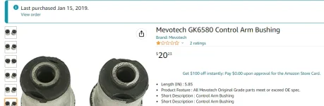

Those bushings are for the REAR, lower control arms. MevoTech MK6580. It's already been verified that these bushings fit the REAR lower control arms.
Rock Auto - MevoTech MK 6580
Is this what you're going to use then? Does not seem you have much of a choice...
Yes, I already bought the bushings and have them in my possession. After countless hours of research that is the ONLY choice one has.

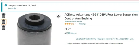

I forgot to mention but I have 4 of these bushings, i think because I bought them to do years ago but then said f that when I realized how involved it would be lol. Brand? not sure
Also I just went to see if I ordered on amazon and I saw this
Come to realize, I apparently bought both this AC delco AND the mevotech. I have both if someone wants to see comparison I guess LOL

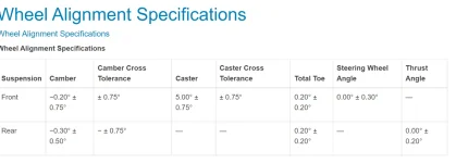

I have had the alignment checked and the camber is way out on both rear wheels.
The assessment was the bushings need replaced. A couple are working out of the of the sleeve(?). The only suitable replacement part that is available is the whole suspension arm assembly. This still available because it is used on the lucerne. However, it is pricey.

just to visualize for you. I seem to recall I posted the AC delco part number for your bushings.
here it is is
