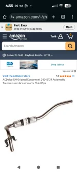

Just in 😀View attachment 37031
Where is this house located? I bought one of these parts on eBay to replace when doing the magnet tsb and filter change but have no idea how to do it or where it goes? I'm also doing a shift kit so I'll have the lines out of the accumulator. Is this one of those lines to the accumulator?THAts what bats are for.
