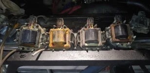

So thinking back as to what all I've done and some of the problems I may have had a MAF problem, a purge valve issue..and while trying to fix it at least 1 coil pack started to act up. The coil pack issue seemd to "almost" coinside with the replacement of the ICM. That ICM gets hot. I did use heat sink greas on it.
