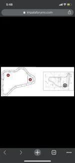

What magnet upgrade is best?? Where sourced and where to place and how many total? I’ve read 2 in the pan and one on the Filter so far
I ordered these magnets!!!
4 of these K&J Magnetics: BY0X02SH
10 of these K&J Magnetics: D82SH
should be enough for mine and moms lesabre lol
Be very careful with these magnet mods you guys are doing. Magnets can very Bradley interrupt with the solinoids in the transmission. Be very careful where you place them and how many you use. Personally, I don't use them. No real need. Doing trans services and inspections is key. I could see replacing the factory magnet for one of the upgraded magnets would be could but imo too many magnets could interfere with all the solinoids in there.
I thought the same thing. But GM recommends the magnets.
I was only going to replace the factory with the 1 or 2 new.
And just one on the filter like on the TSB .
