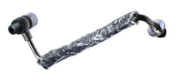

Yes, the 2 oil lines. One is plastic and always breaks the other one has 2 copper crush washers on the banjo nut, one use only. They cost more than a complete new line.2021-08-01.webp

Not for code P0299. That's a leak in the charge pipe. I worked on a 2012 Cruze yesterday ( same engine and turbo ) with 340000kms (211000 miles ) Original turbo. It had a P0299. Cleaned all the charge pipe hoses and reclamped, also changed the oil feed tube that was leaking oil for the revised version. Works fine now.
Wow Again, that is pretty impressive having the original turbo with that kind of mileage. Looks like this little engines when taken good care of it are super reliable. I'm happy you clarified the information because most times people see that code and automatically think turbo replacement, I'm glad all worked out and it was a much cheaper solution than replacing the turbo. Great job!
I think this one had regular oil changes and was using regular oil. The old oil feed tube was almost plugged and would barely flow. It was long overdue if not too late.
When I went to try it out I saw boost numbers close to 10 PSI so turbo is still compressing air pretty good.
From what I had read on other posts here, that feed tube is one of the main culprits for turbo failure mainly because like you mentioned they get plugged from not having the oil change often, maybe not in this particular case since you mentioned it had regular oil changes. I know some people go over 10,000 miles or more before they change it because they are using synthetic.
