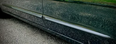

I did the door spears in a satin finish carbon fiber vinyl by Avery. Their product has been easier to work with by far than the 3M wraps. I also did the trim between the exhaust outlets in the same stuff.
