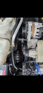

I'm going to have to table the MAF sensor code. I put the old sensor back in. I however replaced the EGR valve and now I'm getting a "55" code. I want to buy a new connector as I believe the wiring by the previous owner may be the culprit? But I can't find one anywhere. Any advice?

that EGR looks new can you get the part number oni t, there are two different EGR and they look identical. well, 3.
And, the connector.. yeah thats bad splicing, i cant find the connector, you can cut the wires out of that splice and then fix them properly. However, you need to have the right wires to the right pin. that could be off.

The part # is AC Delco 214-2129. I repaired the wiring with crimp and heat shrink connectors. I think it looks decent! O.E. wires on the connector are a little dull but not awful.

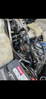

Does my connector look like it is missing a pin? On the top right hand side of the "Y" shape it is blank. I found a replacement online and it shows everything pinned. Mine also only has 3 wires. Should it have 4? Previous owner did a larger wiring repair on it so I am unsure of how it looked factory. I attached a photo of the one I found online.
Does the egr have 4 pins in the cavity? if not its probably unused
the wiring splices were not shrunk and they also were 2 sets of them, dont splice the wire in 2 spots within 6 inches, the better repair is a new pigtail and then one set of splices, if the wires were long enough, offsetting each splice just far enough to not have them next to eachother makes the repair area much less bulky too
