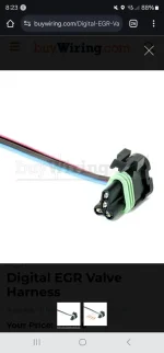

Does my connector look like it is missing a pin? On the top right hand side of the "Y" shape it is blank. I found a replacement online and it shows everything pinned. Mine also only has 3 wires. Should it have 4? Previous owner did a larger wiring repair on it so I am unsure of how it looked factory. I attached a photo of the one I found online.I'm going to have to table the MAF sensor code. I put the old sensor back in. I however replaced the EGR valve and now I'm getting a "55" code. I want to buy a new connector as I believe the wiring by the previous owner may be the culprit? But I can't find one anywhere. Any advice?
Does the egr have 4 pins in the cavity? if not its probably unusedDoes my connector look like it is missing a pin? On the top right hand side of the "Y" shape it is blank. I found a replacement online and it shows everything pinned. Mine also only has 3 wires. Should it have 4? Previous owner did a larger wiring repair on it so I am unsure of how it looked factory. I attached a photo of the one I found online.
