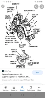

I can remove both belts and put them back on without removing anything but it is not much fun. If I remove the belt over the SC there will be no belt over the AC compressor if I am not mistaken. The AC comes on when needed for a few minutes then the system defaults to VENT since the AC is low on freon. But, if I remove that belt will the car throw codes because the AC unit is not spinning.?
If you remove the supercharger belt, you do not need to put another belt on those pulleys. The Accessory belt will drive everything else. Again, this will not damage anything.
If you insist on doing this, I would also disable the Boost Bypass Actuator.
If I remove that belt all together there will be nothing to spin the AC unit which I do not care since it is low on Freon and if not having spinning causes no damage I would not care. The reason why I wish to do this is because there are funny noises coming out of the SC? I want to see what disabling it will do? Supposedly the mechanics who changed the intake gaskets replaced the SC oil as I asked but I do not trust those two. My fault however...long story...live and learn...
My contention is you are mistaken. I have never seen a supercharged 3800 that uses the same belt to run the supercharger and the A/C compressor. One belt drives the supercharger and nothing else. The other belt independently drives everything else.
No sir. On my 1993 Buick Park Avenue the belt goes over the Super Charger and runs down over the AC unit. Unless I reconnected them we in somehow? I was looking at it last night.

I think you are more familiar with thecseries 2. Mine is a series 1. Confusing at times. Series 3 the best I read? Thanks for all the input! You people are great!
