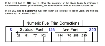

but i notice the O2s(mv) value with 462-471 is higher then it should be at 450.
the air/fuel mixture is to rich, but the exhaust 02 value means its LEAN.
the buick girl from mars is right.
my other datas are in right value.
only the KS counter, the lt fuel trim and the O2s(mv) are outside the norm.
