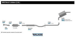

Had a mechanic smoke test the exhaust system and saw nothing come out, but he definitely heard the clicking while driving so I'm not crazy. He used his stethoscope and said he could hear a leak coming from this phalange but could not get smoke to come out of it. He thinks it's such a small leak but gets exacerbated when driving the car (I only hear it when the car is accelerating and moving 10mph+ approx).
So, he recommended leave as is until the leak gets worse and we can detect via smoke, but that the phalange is his best bet.
What do you guys think I should do, and if I wanted to replace that phalange / pipe would I just use the part# from the image BGFM shared #52270 and have a shop bolt/weld on for me? Thanks!1718135352185.webp
What do you guys think I should do, and if I wanted to replace that phalange / pipe would I just use the part# from the image BGFM shared #52270 and have a shop bolt/weld on for me? Thanks!View attachment 46852
