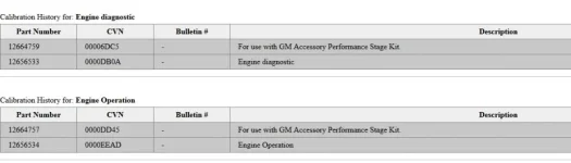

No error codes were set with my GMPP Stage Kit. I drove it to the dealer without any issues.
BTW, you can check whether the software was re-flashed with the new calibration here.
Enter your VIN.
Then select "ECM Engine Control Module Programming"
Click on "Next."
Select "Complete History".
If successfully re-flashed, you'll see 2 entries under "Calibration History for: Engine diagnostic" and "Calibration History for: Engine Operation" indicating "For use with GM Accessory Performance Stage Kit."

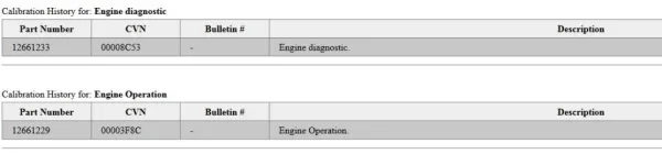

Can you send a screenshot showing the 2 entries under these categories? I do have the GM Stage Kit/Tune but it is not showing on mine for some reason... see attached. It does have the correct codes though per the GM Stage Kit Instructions.

Here you go. Perhaps the difference in the display is due to the difference in model years: my GS is a 2012.

Thank you so much for this! I found the two entries in there.
Is this history screen put in chronological or random order? I do not see a date on anything.
