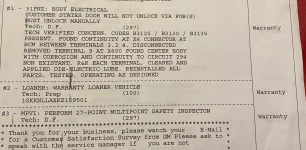

A week after I got home, GM later replaced it all (housing, fuel door) and fixed the root cause (it was indeed a case of an unseated wire grommet, I believe between the door and body harness). I figured this is typical first model year glitchy stuff, but by god was it infuriating. No manual override to the fuel door? People could get seriously screwed by this. And how was I to know about the manual key to open the doors? If I was less physically able, and didn't know about that key, how can I even get into the car?
