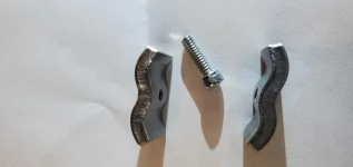

The clamp has around 3 threads so not a huge amount of hold or clamping force but I guess it's enough to hold it in place. The blue loctite should help it from loosening.Clamp.webp

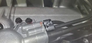

Drained the trans fluid (nice to do with new Dorman drain plug), dropped the pan, installed the AC Delco diff line, installed the Sonnax line clamp. Also swapped out the Duralast filter for AC Delco.
I used Blue Loctite 243 on the threads for the Sonnax clamp. I poured the trans fluid into a clean bucket and reused it since it was brand new (changed it out last weekend).

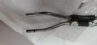

The old diff line rubber appeared to be in good condition, I even bent it and checked for any cracks but it looked good. I could have easily gotten another 20k+ miles out of it 😉
The new AC Delco diff line seemed to be about 1/8 longer on the one end. Didn't cause any issues but just something I noticed.
probably to help it seat better in the accumulator thingy but good work you done well young padawan

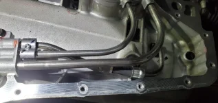

The ATF has to get there somehow.
The differential gears are straight-cut bevel gears, not hypoid like standalone diffs. ATF does not have the additives to protect the sliding motion of hypoid gears, so I'm guessing that lots of volume and lots of pressure for those bevel gears.
The pipe that i have been trying to show yall so you dont blow yours up and get granola in your pan
