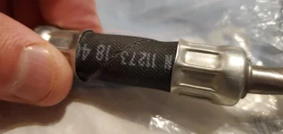

I will think it over on the hose. I really don't like that crease/line in the new hose. I've seen high temp/pressure hoses and they don't have lines like that in the hose. To me, it seems like a manufacturing flaw and a potential weak point where the hose can split and leak.

Can you show us your new hose?
When I bend the hose, the joint line opens up and while you don't see the inside of the hose, it is not well glued/sealed at the joint line and it shouldn't open up like that in my opinion. Why not use a solid piece of hose with no joint lines in it? I've used high pressure rubber trans line hose and it doesn't do that, like this hose does. Not very reassuring. Hose is stamped "Made in Costa Rica"
I'll take a pic of that when I get home and upload it to show you.
That hose is normal.
When they manufacture hydraulic hose is is not just an endless extrusion coming out of a hot-pot. The first inside tube is extruded, usually in 100 foot lengths. It is squeezed out as a 100 foot rod is pulled through the hot-pot. Then the various additional layers are either wrapped as a spiral, or wrapped along the length and self-vulcanized, or braid woven around it.
The top layers are spiral wrapped for protection only. The gap you see is not a joint, it is the side to side placement of the wrapping. The hose is already sealed internally. And then the 100 foot length is completed and cured, and wound onto a large spool.

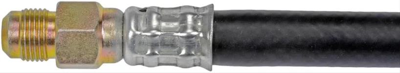

Here is a high pressure transmission line. Notice the hose does NOT have any joints in it. It is a solid piece of high pressure rubber trans line hose. Unlike the hose in the other photo.
They make both kinds. No matter what ... new is better than old.
that is not submerged in Dexron VI and exposed to operating temperatures -40 to 250 f and pressures all over the map and for years
